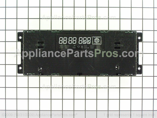

I have a Frigidaire FGES3065PFD slide in range, and the oven doesn't heat. This problem is consistent with Bake, Broil, and Convect settings. It appears as if everything in the oven is working properly, controls respond, fan comes on, etc, it just doesnt heat and the temperature never goes above 100 on the display during bake/convect and never heats during broil. Are there any known issues with this model? Can you share the service manual?

Ok, then it has to be the oven control board that's the culprit.
Here's the oven control board for your model:
Controller 5304503758
135,732
Excellent @blessedpop glad to hear the new oven control board fixed it.(y)
