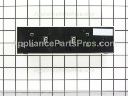

Frigidaire Model FFHS2311LBQA issue with warm Fresh Food side. Seemed to start after area-wide power outages. Service Mode Test 9 showed Error Codes 5,6,27. Ran Damper Motor Test 5-A, Display ="0". Test 5-B, Display ="_". Test 5-C, Display ="_" But the motor continues to run, indicating "a problem with the damper switch or damper switch circuit". When I opened up the Damper Assembly I found grit from the switch contacts on the camshaft and the contacts appeared to be slightly misaligned (contacts not flat on flat but contacting at an angle) so I replaced the Damper Motor/Switch/Assembly. -- Test 9 Error Codes now E,5. Ran Damper Motor Test 5 again with the same results as above. Assume this means issue is with the "circuit" but not sure where to check that or how to test now.

So the damper is running, so the problem is the damper switch circuit in the temp control board.
Here's the temp control for your model:
