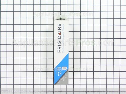

Do you have the by-pass cartridge? It comes with the refrigerator when you buy it new. Put the bypass cartridge in and see if it does that same thing, if so and you have good water pressure to the refrigerator, then its definitely that filter head that's the culprit.
Here's the bypass cartridge for your model:
