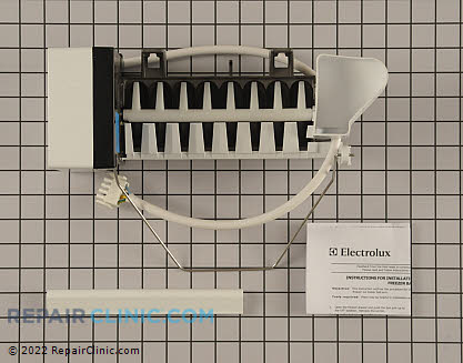

  4. Ordered a New Ice Maker Unit
    1. Current ice maker has not moved / rotated at all since installing the new water inlet valve. I manually did a full rotation with my screwdriver, to no luck.
    2. My belief is that the ice maker unit itself is broken / defective
  5. Also, not sure if this matters, the fridge has the original water filter installed, since we never had water connected in the past, we never bothered to replace it. Upon removing the filter, it is bone dry.
Next step would be to replace the ice maker and go from there, but if a new ice maker unit does not solve the issue, not sure what else to try.
Hi, try to test cycle the ice maker first.
Test Cycling: Remove ice maker plastic cover by inserting screwdriver in notch at bottom and prying cover from housing. Use screwdriver to rotate the small gear counterclockwise until about 1/4 to 1/2 turn. Then the ice maker gear should keep turning on its own till the end of the ice maker cycle.
If it does not turn on its own check for 120 volts between the Light Blue wire and the Black wire.
Here's the ice maker for your model:
Ice Maker Assembly 5303918493
Hi Jake, I rotated the ice maker gear about 1/2 turn, it did not keep going on its own.
I'll try testing the ice maker, do you recommend ordering the part regardless, let's hypothetically say the ice maker was getting 120V, what would my next step be?
No, it won't make sense to order the ice maker if your not getting 120 volts to it.
