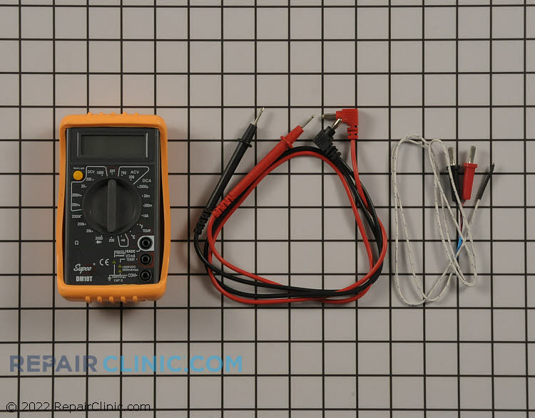

You'll need to get a multimeter like this to check voltage to the compressor start relay properly:
Digital Multimeter
