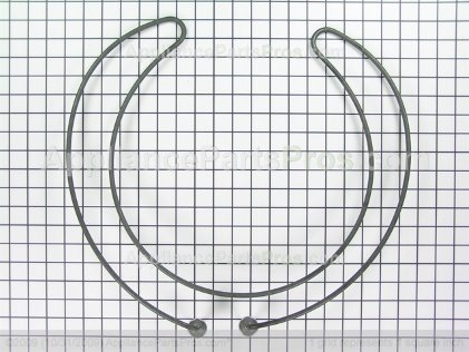

Good job, you are exactly correct, the heating element is the cause of your CSM tripping.
Here's the heating element for your model(Video Included in part link):
Heating Element WD05X30818
Welp the heating coil has resolved the tripping and it's working now. However the CSM is still tripping after completing cycles and just idling between unloading & reloading. I haven't gone back through the troubleshooting, but it's really odd considering the main board was already replaced within the last year.

Glad to hear the new heating element fixed the CSM from tripping.(y)
