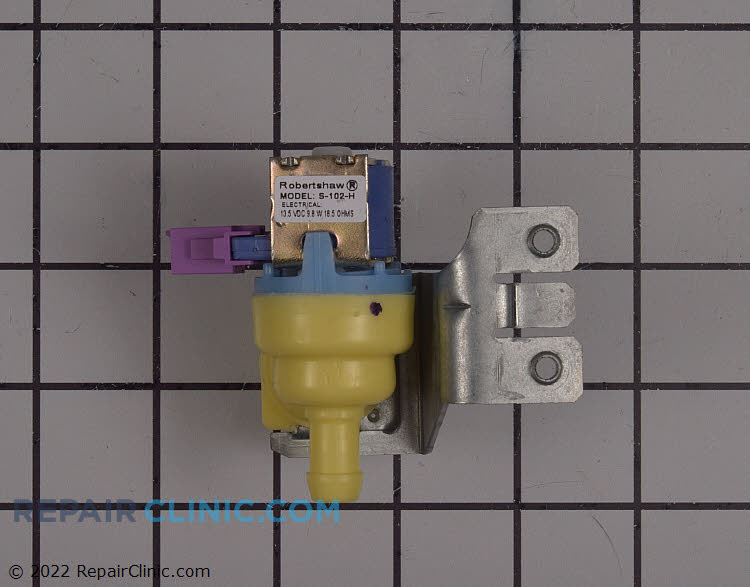

Yeah this is what I did exactly! I have mixed results on cycles so I'll start with replacing it regardless. After that would you suggest the inlet valve potentially?
139,461
Yes.
Here's the water inlet valve for your model, if needed:
Valve WD15X26078
There is a video in that valve part link that shows you how to access it.
