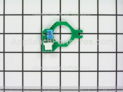

Looks like it has to do with the cooling fan.
Here's that blower motor that's in the service bulletin, in case you or others need it:
GE changed the part number WB26X29060 to part number WB26X32571

Bigbuck, Jake, bingo! I have 11 instances of Error code 350. How do I get into the service test mode to complete my tests?

The oven was repaired today. The Hall Effect sensor on the cooling fan was bad. a fairly common failure according to the tech.
Thanks to all for the help.
