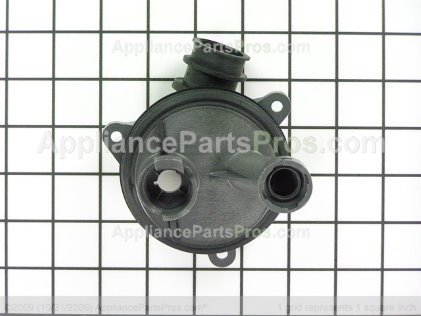

Problem: Leaking water from bottom of dishwasher in large amounts and in shape if circle waterfall when leaking. I’ve attached a picture of the the leaking area that was still leaking water an hour after turning off cycle. Water leaks in large amounts when dishwasher is running.

Usually its the diverter assembly that leaks on these models.
Here's others that had this same leak:
Here's the diverter assembly for your model:
WD19X25278 Diverter Asm Kit
Jake, thank you for the recommendation. I replaced the diverter assembly and found a damaged area of hose. However, the dishwasher is still leaking from underneath even with the new part. It’s when the cycle starts spraying water. No leaks when drain was pumping. I heard water and spray arms spinning then saw water coming out. Any ideas on what else could be happening?
Disregard. Clamps weren’t tight enough on on the diverter assembly. That resolved the issue.
Excellent, good job finding that was the issue after replacing the diverter assembly.(y)
