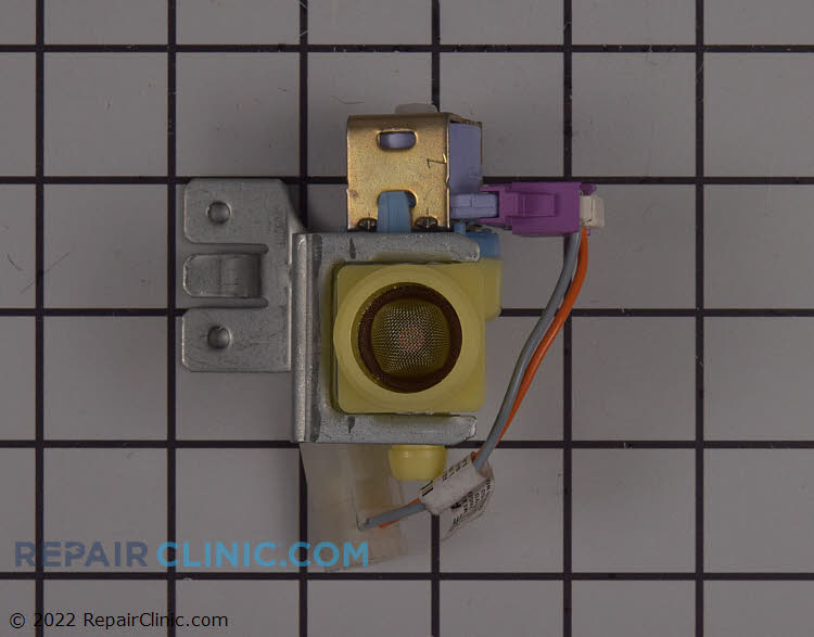

You can also check the water inlet valve screen to make sure its not clogged with sediment. Turn the water supply off to the machine and check the water inlet valve screen.
You can see the screen in it in the photo below:
Water Inlet Valve WD15X26140
