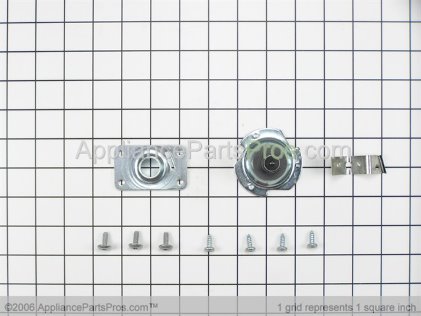

It is making a loud squeaking sound, which I believe may be where the bolt (for lack of a better term) on the back of the drum inserts into the back of the unit. Is it safe to attempt to spray some lubricant into that area? I assume that's not a good idea, as typical spray lubricant is highly flammable.
Thanks again!
Not a good idea, I agree.
Sounds like the rear bearing is worn out too.
Here's the rear bearing assembly for your model:
WE25M40 Rear Drum Bearing Kit
Here's the video:
Thanks so much! I may or may not have the ambition to take it apart once again to replace that part. Either way, appreciate all of the solid advice!!!
