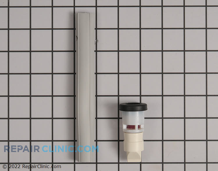

Here's the drain line tube for your model:
Asm drain line
If ALL the water went into the drain pan and no water came to the front where its leaking, then it MUST BE condensation.
