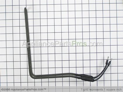

Here's the defrost heater for your model:
WR51X322 Defrost Heater Assembly
All you do is ohm test the 2 heating element terminal ends and see if you get less than 50 ohms on your meter. If so, the defrost heater is good. Make sure power to the refrigerator is disconnected before accessing and ohm testing those parts.

Did some more digging and am afraid I'm over my head... I was able to remove the drip pan by disconnecting the two wires and ground. Disconnected the heater - resistance reading was unstable (crud on connections?) but seemed to be around 45 ohms. If so, it's working (consistent with the evaporator coil not being frozen up). Even if the heater was bad (doesn't seem to be the case) I can't see how to get it off the coil from below and can't see how to access from above.

The evaporator coil looks good.
If the defrost thermostat's and defrost heater was bad, it would have massive frost build-up on it, like in the DEFROST PROBLEM photo above.
