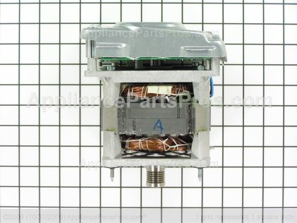

Here's the motor/inverter assembly for your model:
WH20X20229 Motor and Inverter Asm

Then the new motor/inverter board should fix it.:)
