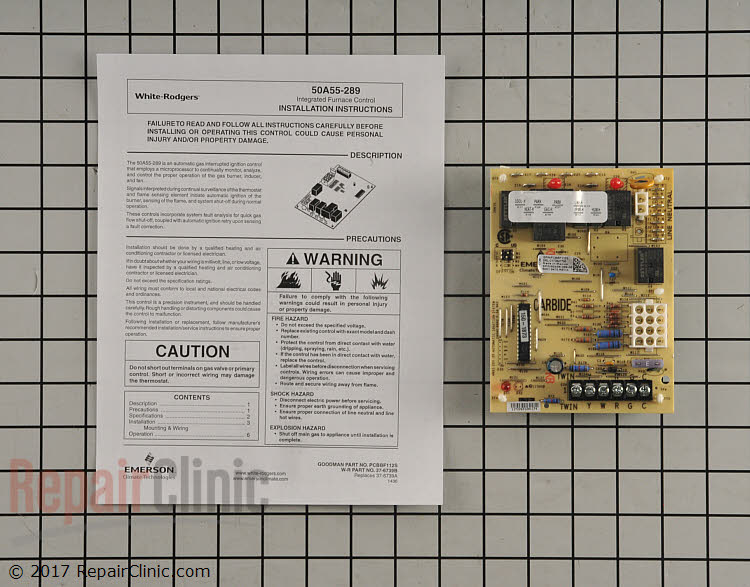

Thank you for all the help. FedEx finally came through with the delivery today - next day air ended up being a little more like standard ground. I swapped out the wires from the old board to the new board one by one, turned out the power, and for the first time in about a week we have heat. It's gone through several heating cycles without an error code, so I'm cautiously optimistic that we're in the clear.
Only real issue I had was that there were a few more terminals on the new board than there were on the old one. So the top right corner of the board got a little dicey. I believe I reasoned through it correctly (top to bottom, skipped the terminal that wouldn't fit a connector, etc.), and I feel like the furnace's functionality is a good sign. I'll take a look through the wiring diagram tomorrow just to verify.

Excellent, glad to hear the new main control board fixed it.(y)
Here's the main control board for your model, in case others need it too:
Furnace Control Board PCBBF112S
