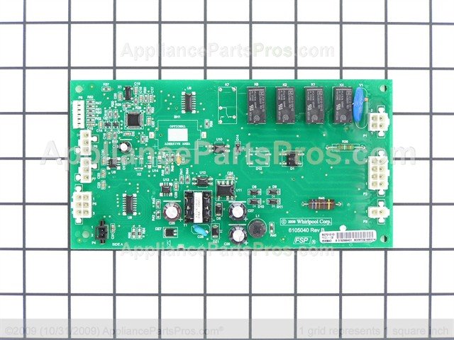

If your wires are not cut, then the problem is most likely the dispenser control board.
Here's the dispenser board for your model:
WP2303843 Electronic Control Board
