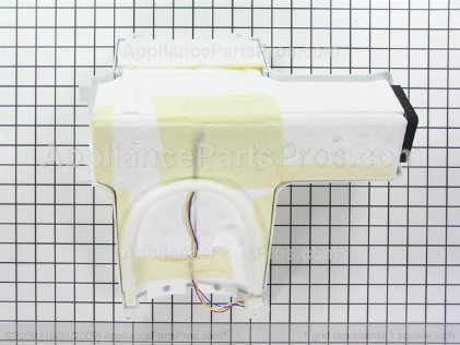

Here's the damper assembly for your model:
WR49X10251 Cover Asm Ff Inlet
Watch this video to remove the damper assembly to see if the damper door is closed on it, thus not allowing the cold freezer air to cool the refrigerator section properly:
