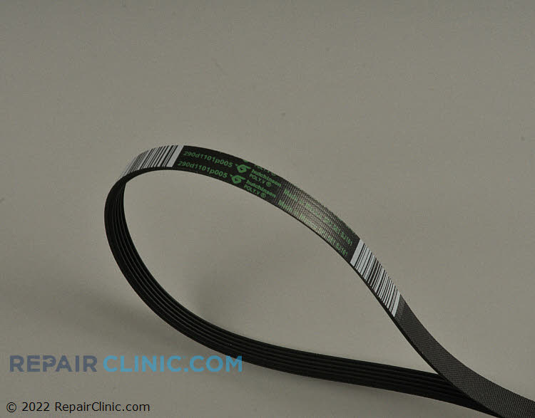

First thing I noticed, the drive belt had gotten twisted somehow. I know pulleys are meant to work only one way so I'm not sure how that happened. Then I took the belt off to get it straightened out and saw where it was coming apart. I put the belt back on & brought the washer back inside. Same thing only this time I noticed a little bit of water being dispensed like a normal spin cycle. It would spin for maybe 30-45 seconds and then stop, never really getting up to full speed. I took it back outside and turned the belt around. I don't know why but this one has grooves on both sides, which doesn't make any sense to me. Brought the washer back in. Same thing. Is this my culprit? Is there any recommendations on which one to get & how to get it here quickly?
I made sure all of my connectors were snug and there were no loose connections anywhere. I'm assuming it's the belt causing problems.
Thank you for your help! So the frayed belt is probably what led to the spin cycle not working?
Yes, I agree.
