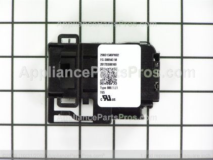

Error code 14 - Lid Lock Fault
Check lid switch continuity at J513 on the control (red wire - yellow wire)

OK maybe a coincidence but I think you might have two separate problems. Were you having any washer issues before the knob broke? Do this:
Go into service mode and write down any error codes. Then clear all the service codes. Check the wires and connectors between the main board and lid lock assembly for continuity and make sure all the connectors are on tight. If the wire harness and connectors checks good, replace the lid lock assembly. That will most likely solve the problem.

Previously I had no problems with my washing machine. The only reason I replaced the control board is because the stop-start button got pushed too hard and broke-off on the control board. My Lid Lock works. The only mode that actually works on my washing machine right now is the Drain and Spin. The lid lock locks, the drum spins perfectly fine so the clothes drain out enough that I can put them in the dryer. It just won't start a normal washing cycle. If I put the washing machine into test mode and move it to a wash test, it will fill with water and hold the water if I press the stop button. However, if I try to run a normal wash load, the washing machine fills up with water and then immediately drains and then the sensing fill light starts flashing. It keeps flashing and doesn't go to any other mode until I press the stop button. My drain hose is fine. I have no siphoning issues. I'm assuming it's something with the programming I'm doing. Please tell me how to clear the error codes once I get them all. Thank you.
