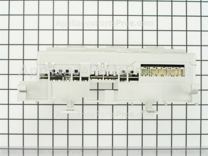

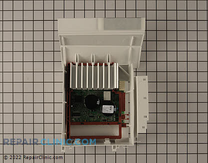

TO CHECK: Visually inspect the MCU for burned spots on it first. The MCU is located on the left side once you have the lower access panel removed.
Now if you find burnt spots on your MCU, then that's the problem, just order a new MCU from the link below.

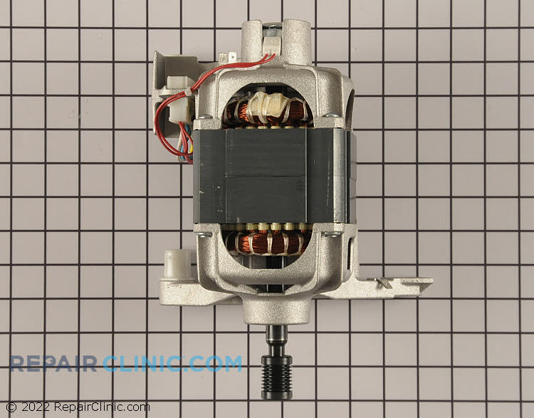

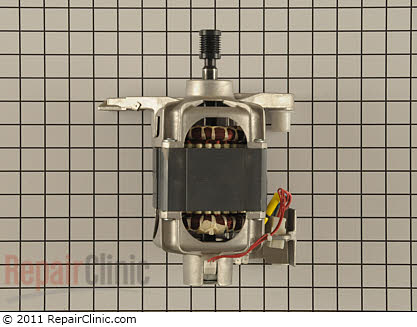

Now if you DON'T find burnt spots on it, it can still be bad, but we would need to ohm test the motor itself first to see if your motor is good.
You will need a multimeter to ohm the motor pins.
Remove the electrical connector from your motor then on your motor connector pins itself - Test pins 1-2-3. 1-2 then 1-3 then 2-3 should measure 6 omhs. If you get 6 ohms on those pins each, then your motor is fine, so you would just need to just order a new MCU from the link below.
Here's the motor control unit(MCU) for your model:
Motor Control Board W10756692
Here's the motor for your model:
Drive Motor WP8182793

Is the connector removed from the front or the back? When viewed from the front of the machine, the wires leading to the connector are black. On the back side of the connector, the wires are red, white & blue. The connector seems as though it can be pushed through the body of the motor, but I couldn't figure out how to remove it. Can the back panel of the machine be removed for access to the back side of the connector? The image attached is viewed from the front of the machine.

Yes Dennis, from the front, cut that plastic zip tie first, then that connector should just unsnap out from the motor.:)
There's 5 terminals on the connector. No continuity between any combination of them. No click from the CCU, and the MCU looks fine. Think it's the motor?
That's odd, I don't think your ohm testing at the right place.
Pretend you just ordered the motor and you have the motor in your hand.
Look below, see the plastic wire connection block on the left side of your motor? Disconnect the wire harness block that snaps into that, then test at the motor connection block you see in the photo below on the left side.

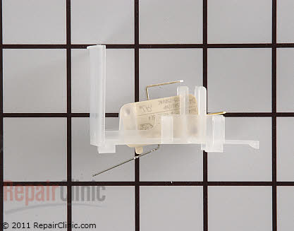

FIXED!! Can't believe how simple this ended up being! While trying to understand why the ohm check wasn't working, I noticed that the switch that mounts to the chassis on the lower rear corner had disengaged from its mounting. There are two wires from the motor that go to that switch. The switch has a toggle that gets engaged when it's mounted. I reinstalled the switch and got the high speed spin back! Thanks for your help Jake!
Excellent, good find Dennis!
Here's that interlock switch for the front panel:
Micro Switch WPW10085220
