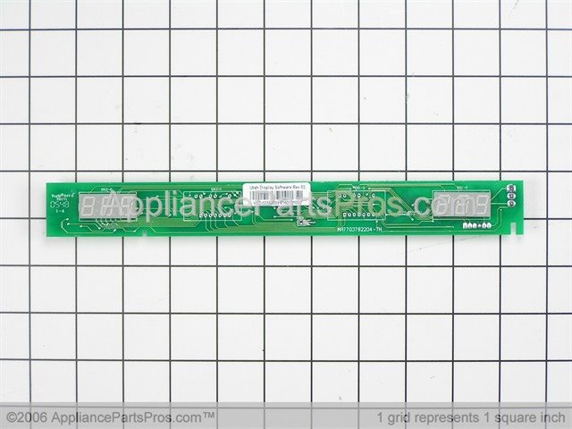

Hello,
Great site - thanks for the assist.
I have a Maytag Refrigerator, French Door, with the freezer on the bottom, and the water dispenser inside. The model number is: MFD2561HES, and the Serial Number is 10419386GL.
The digital display inside is frozen at "0" degrees for the Freezer, and "40" degrees for the refrigerator. None of the buttons operate. A local repair shop wanted $375 for the part, plus labor to replace the main board. Google said there was a better way, and I now have a GE Main Board, Part Number WR55X10942
The instructions are a little scary, and I am hoping you might please help me.
I can remove the old Main Board and install the new one, that is not a problem - posts here have diagrams, and I've built a few computers in my time, so the card installation looks fine.
The instructions, however, say I need to CUT the "Thermistor" wire of the J1 connector, AND cut a green wire located at the "machine compartment access panel", in a "capacitor board in the plastic housing"- where ever THAT is.
1) First off - I'm confused why a wire needs to be cut, and what in the heck a "Thermistor" is.
2) Second - I have no idea what they mean by "machine compartment access panel" - where is it? How do I find it?
3) Again, I need to cut a wire in the refrigerator interior wiring? Really? Why?
4) Some web sites I found on Google say that I need to PROGRAM MY REFRIGERATOR to tell it that there is a new card, or PROGRAM the new card so it knows what refrigerator it is installed in. Some even reference to reaching under the refrigerator for some sort of card with the "secret" information. I've found no such instruction on this site with reference to these Main Board replacement discussions. Is there something missing?

Well - there you go! Thanks. I had already done more research today and figured out I probably bought the wrong card - and since I bought it on ebay - I'm stuck with the wrong card, and I need to buy a ANOTHER card.
The cheap repair just got expensive.

#2(from the parts diagram above) just snaps in place, just unsnap it in the front with a flathead screwdriver.
Yes, thats why I never recommend anyone buying parts from ebay.:)

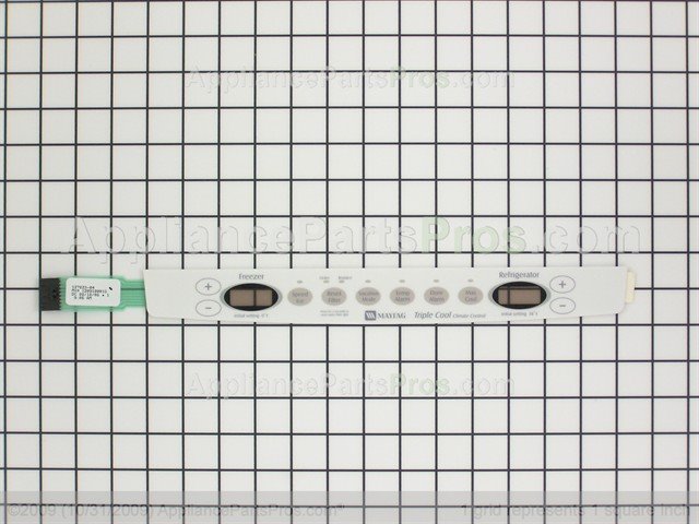

Well.....are the any more ideas?
I've replaced the above pictured part, and the push button controls are still not working. The temperature reading appears to be working - it started at 68 degrees and is headed down in the refrigerator - but pushing the buttons to set the temperature are still not working.
Now, it's only been a few minutes so I am wondering if it is simply taking the refrigerator down to the "initial setting" - and then the buttons will work, or is there another controller card? Or did I buy a bad controller card?
Or - do I need to replace the BUTTONS? (Part #12 in the diagram above) or, do I need to replace the other circuit board - your part #1515036?
I know that this is limited information - so, any ideas or places to look are certainly appreciated.
Thanks.

Yes, then you will need to replace the button keypad assembly as well:
Touchpad WPY67005640

We find the fluff boards in the control don't do much. The real control board is at the back bottom beside the compressor.
High voltage control board

OK - well, now I don't know what to replace! The keypad, as suggested by Jake, or the Control Board as suggested by Jeff.
FYI - the filtered water does not appear to be working. I thought it might be because the water was frozen due to the cold interior temperature of the refrigerator - but, now - WHO KNOWS!
So - any ideas, or should I just replace both?
Thanks guys, I appreciate the help.

We have had to replace a couple display and key panals before and on most ( not 100% all, just most ) we had to go back and do the HV board as well! ( POS ).
JMO, do both.
