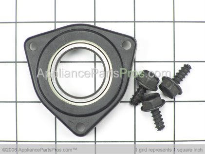

You have 2 spin bearings, upper and lower, I'd check the lower bearing first to see if it turns rough or smooth. Unfortunately, both the spin bearings are no longer available new from the factory anymore.
Here's the lower spin bearing:
12001562 Bearing Assembly (lower)
In order to access the lower bearing you would need to remove the thrust bearing and the brake assembly from the unit. The brake tool to release the brake spring is No Longer Available. A member back in Dec. 2008 was able to use longer screws in place of the shorter screws to release the brake spring pressure, thus avoiding the need to purchase the brake tool: FIXED Admiral washer LNC6760B71 snubber
Here's the thrust bearing kit and video that shows the way to remove and replace it first to get to the lower spin bearing.
12002213 Thrust Bearing Kit
Then once you have removed the thrust bearing kit and brake spring, then there will be 3 bolts you have to remove to get access to the lower spin bearing. Once the bearing is removed turn it both ways to see if it turns rough or smooth, normal would be smooth.
