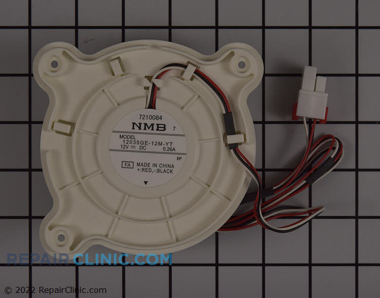

hi i need the service manual for a Samsung RF220NCTASR/AA-02 any help would be appreciated. the evap fan is not working i replaced it along with the damper assembly and the thermistor in the refrigerator compartment i would like to confirm that the control board is bad before i replace it
I couldn't locate the service manual for this model, but if your not getting 12 volts DC to the evaporator fan motor when it should be running, then its a bad main control board.
Here's the main control board for your model: Assy Pcb Main DA92-00426G
For others following your thread--->Here's the evaporator fan motor for your model with a video:
Evaporator Fan Motor DA31-00334C
