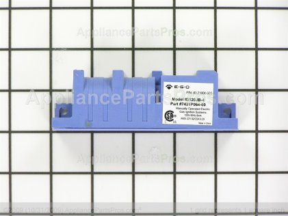

I don't know what that says but here's how it works; When ever one of the ignition switches is closed , a circuit is established to all the igniters and all igniters spark. Only the gas valve that is open will ignite. If one of the igniters doesn't spark, switch it with a known working igniter. If the igniter works replace the failed igniter. If the good igniter doesn't work, replace the spark module. Since the cartridge is new I would assume the igniters are good. Make sure it's wired correctly.
Spark Module

I cracked it open. The wire to the front burner broke at the clasp that attaches to the burner. Can these just be soldiered or do I just buy a new unit. Also, I looked for the replacement part and can't find it (this is an older stove). Are these universal controls?
The picture below is not the broken end. It snapped at the end that looks like a clasp (I know my jargon is completely off).
