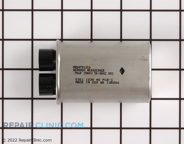

Check the high voltage capacitor for being shorted.
https://www.applianceaid.com/capacitor-testing.php
