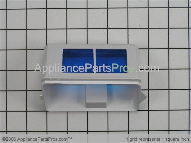

At first, I thought the damper was the little slider device on the fridge wall on the freezer side. It is a simple device that goes from "COOL" that closes the small door to "COLD" where it is wide open. Cold air is flowing thru that and I've always kept it about 1/2 or 3/4 open just for yucks.
But I don't think that is the damper. It isn't shown in the controls but in the "Shelves and Accessories" diagram. Not clear what drives the air thru this device. It is simply called the Cool/Cold Slide Control and Housing. Also has a retainer. I'm guessing the Operator's Manual, which I don't have, provides insight as to how to make use of it.
But the Damper looks to be a more significant component near the top of the same fridge sidewall. There is a rectangular opening but no air flow seemed to come from this opening. The opening is the exit point and behind that is a styrofoam insulated "tunnel". I assume this is where the majority of cold air should be entering the fridge.

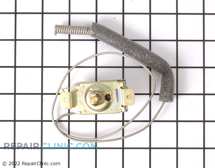

I was waiting on the new ADCB and meanwhile checking to see if I could determine what else might be wrong. I kept my thermometers in the freezer and fridge. Tuesday morning I woke up to see the freezer was at minus 13 F and falling. Way too cold and the compressor running.
The Temp Control was set at approx. where I had always set it. So I moved the Temp Control down scale until the compressor kicked off.
I had never tried to check the temp in the freezer or fridge before but it was obvious I had the Temp Control set for way too cold.
Thru the day, I continued to watch the thermometer and 4 or 5 times I reset the Temp Control down scale. Each time the compressor would kick back on and drive the temp to minus 7 before I would reset it again. Finally at the end of the day I had it where the compressor would kick off at about minus 6.
The freezer temp would then rise until it was about minus 0.5 +/- a few tenths when the compressor would kick back on and then off at about minus 6. I was happy to see that the compressor was cycling and no longer running continuously. That problem seemed resolved.

Pic attached shows the small COOL/COLD port. I have it wide open. You can see the rectangular opening of the insulated damper tunnel above it (next to the light).
2nd pic shows the fridge Damper Control and the freezer Temp Control.
