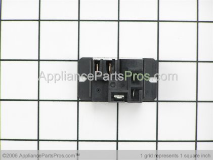

So I'm just looking at the tech sheet and it looks as though the board in the pictures above is only for the downdraft and has nothing to do with that buzzing relay above. I'll attach the tech sheet here. This thing has me baffled though. I've even replaced the control board on the front and it's doing the same thing. Hmm. Stupid question....when checking the bake element and broil element are they supposed to be 120 or 240 when heating? Right now they're only 120. The buzzing relay (T9ap5d52-24) is marked D.L.B relay. I'll attach a pic of that relay as well.

Here's the D.L.B. Relay for your model:
Relay WP74003482
Are both the bake and broil elements not coming on at all? You should be getting 240 volts at the Bake and Broil Elements.

What's the buzzing sound? Is that the new DBL relay you just replaced? Where did you get it at? It may be bad, let's test it with your multimeter:
Plug the range in and set the meter to read Volts AC. Connect one meter lead to the L1 (black wires) terminal where the power cord connects to the range. Touch the other meter lead to one of the red wires on the relay and then the other red wire. You should read 240 Volts AC both times. If the relay checks good you'll need to replace the control board (EOC).

137,406
Hold on, let me ask Rick, I remember he made a diagram of this DBL relay testing procedure , but I can't find it and I want to make sure this is right.
rickgburton
Jul 11, 2006
44,782
I couldn't find any relay diagram for this machine. I made one for the evenheat dryer a while back. You're just getting old Jake. Your memory is playing tricks on you...LOL
I get 40 volts coming to the relay from the control unit to the 2 black wires on the relay.
That's why the the relay is buzzing. It's a 24 VDC coil. Measure the resistance of the coil (2 black wires). Check for approximately 575Ω. The double red wire is L2 common for both elements. The single red wire is L2 supply voltage. When the coil is energized, the magnetic field closes the contacts between the two red wires. So your board is bad because it's sending the wrong voltage to the DLB coil and you should recheck the DLB relay. The high voltage may have damaged it.

Ok, so I get 553 ohms on the coil. I get roughly the same for both relays that I have.
It's looking like the control board I assume right?.
The voltage going to the coil in bake mode for this new (old) control board is 17.5 when read off the relay and roughly 16.5 when read on the relay.
(Note) when I initially read the voltage going to the coil with the other control board and got 44 volts I was reading it as AC....just to add to the confusion. So I really don't know what that was. Sorry!
That's not enough voltage but low voltage is more common than high voltage. That will also cause the relay to chatter. 7V can be in a pinched wire, almost broken wire. or bad connection Worth taking a close look at.
