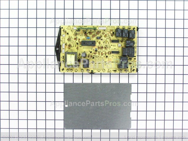

Any other checks I can do? Could it be the Relay Board?

Re-check the sensor and wire connections on the power relay board. If the sensor checks good and the connections are good replace the power relay board.
Relay Board W10757086

I checked all the connections but still got the fault. I replaced the power relay board last night and the fault is gone. Oven, broiler, etc. all work again. I was surprised there were 21 connections that went into it.
It looked like a capacitor was leaking on the old one.

I have the SVD48600P. it is giving an F5 sometimes. and the first issue was the broiler did not work. then yesterday the convection fan was coming on an off and then the F5 showed. Do I need this Relay Board? also how do I replace it?

OK, F5 error is power to the element relays was disabled/interrupted. Disconnect power to the range, Check for any loose wire connections on the power board. Check for any pinched or broken wires. Check the oven sensor connector on the board. Check the oven sensor with a multimeter.
At room temperature the oven sensor should measure about 1100 ohms.
Here's the oven sensor for your model:
Temperature Sensor 12001656
If your oven sensor ohm tests good, then its your relay board you will need to replace. You need this relay board: 12001690 Board, Relay W/shield
But its no longer Available for your model.
Pull your range out from the wall, then unplug it. Its located in the very back of your range, behind the back access panel.
You oven sensor connector is in the very back of your range too, just disconnect it and ohm test it, make sure you keep the range unplugged when ohm testing it.
