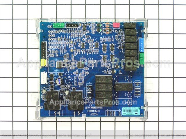

Just the Appliance Manager board does.
P8-4 and P9-2 on the appliance manager goes to both blowers.
BLOWER MOTOR-LOW SPEED--->P9-2 (GY) to Neutral (W)
BLOWER MOTOR-HIGH SPEED--->P8-4 (GY/ BK) to Neutral (W)
Here's the Appliance Manager for your model:
WPW10292566 Electronic Control Board(Appliance Manager)

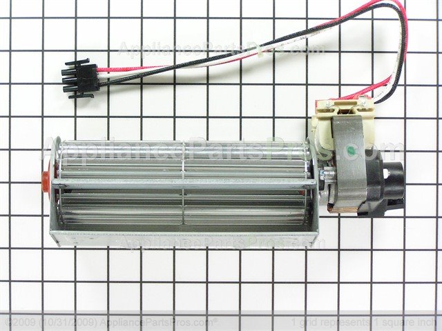

Here's the LOWER BLOWER MOTOR for your model:
WPW10273666 Blower
Here's the UPPER BLOWER MOTOR for your model:
WPW10273667 Blower
