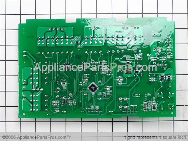

Jennair JEC0530ADB front right dual element stopped working, touch controls do not light up.If I flip the breaker off then on the touch control for the element will light, the fan comes on and you can adjust the setting.....after about 20 seconds the control for that element goes blank and will do nothing...won't light up unless I power cycle the cook top.
I tested the element and I do have continuity through all three legs of the element, temperature sensor has continuity, visual element looks fine.
All other elements work fine
Any ideas would be helpful.
139,315
That sounds like the main control board is failing causing that front right dual element to do that.
Unfortunately, its no longer available:
Cntrl-Elec 8507P200-60
