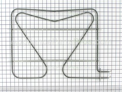

Have you ohm tested your BAKE heating element? Make sure you disconnect power to your machine first!
Here's the BAKE heating element for your model:
Unit Asm WB44T10104

I appreciate your help. Both elements turn on but they never get really hot. I turned the oven on BAKE and it's at 193 degrees after about 25 minutes.
We did not ohm test the bake heating element. Are you thinking this could possibly be the issue even though it turns on and gets slightly warm?
Yes.
