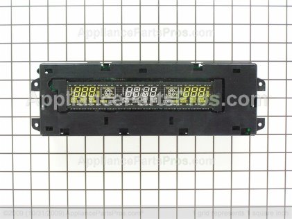

Hey Friends, our 14 year old oven is not getting to the set temperature. It's like 70 degrees short. The element is like $80 but I don't want to guess. Everything else on the oven is normal, the fans, display board. Any thoughts on how I could diagnose. Thank you!

Ok, more intel. Wife says bottom oven and now top oven temps way lower than settings. Reading on this forum many say control board is bad and they may not make them any longer. :cry:

That's the first thing that came to my mind in your first post, was the oven sensor, but then your 2nd post said BOTH ovens were having the exact same issue, and having both oven sensors go bad at the same time is unheard of. LOL
But if you want to ohm test both oven sensors, you certainly can.:) Disconnect power to your double oven first! Then instead of pulling the double oven out, you can remove the screws from each oven sensor from inside the both ovens and pull the oven sensors into the oven slowly until you see the plastic electrical connector, then remove that connector and ohm test them.

Hi Jake, I have my new control board and am trying to take the old one out. I can't tell how far I have to disassemble :eek:

I pulled the oven out, took off both metal side panels, then the control panel, only to realize I did not have to do any of that. The control panel had 3 screws underneath and was hanging by two pins. Oh well. I did not find one video showing this procedure. Now, what to do with the old part.

So far so good. How much did I save by doing this myself. Part was $400.
137,440
Excellent Gary.(y)
You saved about $200 doing it yourself.:)
