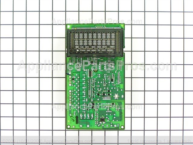

I have a ge microwave, model JVM7195DFBB.
Today it started producing a buzzing/humming noise when the door is closed.
The light turns on, the fan turns on and the turntable spins.
Is it the relay switch or a faulty board altogether. The door only has 2 prongs that slide into holes when the door is closed, there is no open/closed position for the door prongs.

Board issue :(
LINK> Main board assembly
