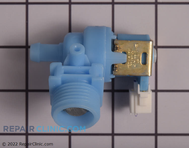

When you start a new cycle and after the water fills the tub, open the door and see how much water is in the tub.
If you see very little water in the tub, Turn the water supply off to the dishwasher underneath your sink, then take off the water line that connects to your water inlet valve and see if your screen is clogged up, thus not letting enough water come in the dishwasher.
Water Inlet Valve W11175771
There is a video in that part link that shows you how to access the water inlet valve, see the water inlet valve screen in the photo above?
