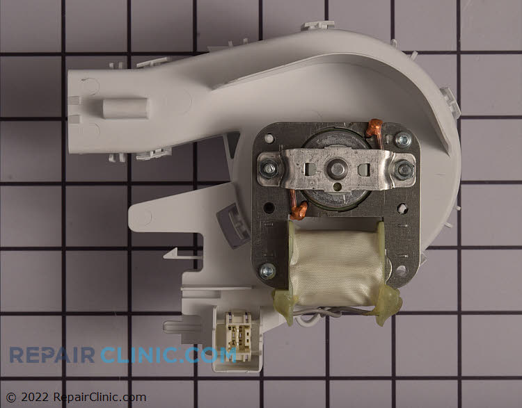

Here's the blower motor for your model below, when you click the part link to it, you will see a video that shows you where it is.
Blower Motor W11228135
You should be getting 115 volts to it when it should be running.
so far so good, 4 loads in.
Sounds good, thanks for the update.(y)
Yep, I replaced that blower motor and it’s running good, at the end of the dry cycle. Hopefully now we can get several more years service out of this bugger…

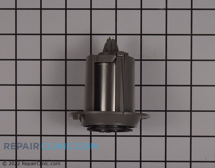

Yes, your pump filter is in very bad shape, one of the worst I've seen.
On these models there has been a problem with the pump filter breaking and jamming up the wash motor.
Mike took lots of photos and documented them here too:
Here's that pump filter for your model, in case others need it too:
Pump Filter W11084156
If not in-stock at RepairClinic, It's also here: W11084156
Here's the wash motor for your model that comes with the pump filter already installed for you, in case others need it too:
Circulation Pump W10902589
If not in-stock at RepairClinic, its also here: Circulation Pump W10902589
