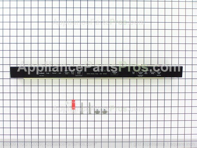

Here's the control panel keypad assembly for your model, if needed:
W10903576 Panel-Cntl
