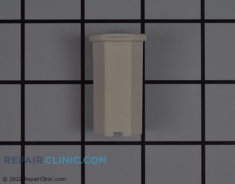

Service Pointer #W11540964 re: heater element bushing
One of the threads pointed to a service pointer that included the following details:
KDTM404K*, serial numbers: F94601001-F952*/ All FX serial numbers/ FA01*- FA1301402
Unfortunately, it doesn't look like my serial number is part of the bulletin? KDTM404KPS 0: FA2403128
However, when I compare the photos in the bulletin, the covered photos seem to match my element bushing? Photos of both ends below:

Did you try to tighten that heating element end terminal nut tighter to see if the leak stops?
Are you absolutely sure that leak is coming from the heating element terminal end? After it fills with water turn the breaker off to the dishwasher and feel that heating element end terminal nut for water on it dripping down.
Here's the heating element kit for your model, that comes with new rubber bushings:
Thanks for those suggestions Jake!
For your first suggestion, I should unplug the terminal and then tighten the white nut from the exterior as shown in the video/photo correct, then plug it back in? I shouldn't touch anything from the interior side? I'll give that a go!
I tightened the nut by hand and already heard some cracking already so I didn't think I should use a wrench like in the video. I started up the washer and it began to leak pretty quickly. I forgot to check the element itself to see if water flowed down it. Are there any other possible leak points near it? I think I might fully unscrew both, pull the element out, then reseat and rescrew in. That'll give me a chance to take a look at the hidden part of the element.

Quick update, ended up just replacing the heating element and the nuts just to make sure. Tried a quick rinse-only run and saw no leakage. Will be doing a load tonight.

Here's the heating element nuts for your model, in case others need them too:
Nut W11538351
