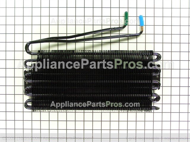

I hate giving up on this Kenmore, it isn't that old, it like new shape, but I know they aren't made like they used to be. I even left the plastic on the outside of the doors to protect it while remodel work was being done. I did put it in diagnostic mode and the RC evaporator fan that was in question does turn on. The FC evaporator fan is noisy now and does run in diagnostic mode as well. If the leak on the evaporator is small, can it be brazed back? The FC evaporator looks like it is aluminum and I know that copper and aluminum can corrode. I have seen new OE evaporator coils as low $154.99. Unless the compressor is shot, those are $349 and up from what I have found. It almost looked like when this refrigerator was built, there was plastic heat shrink on the joint of evaporator coil.
137,470
No, not on that aluminum evap coil. You'd need to replace it.
Here's the refrigerator evaporator coil for your model:
Evaporator WPW10643261
Compressor/sealed system work is not a repair a normal consumer can do. Doing compressor/sealed system work is very unique craft that you need to be trained in with lots of hands on experience.
Doing sealed system work requires you to have a turbo torch, acetylene for the torch, knowledge of how to use and weld with a turbo torch, also having a vacuum pump, and the proper amount of R-134a to use, changing the Filter Drier as well, solder, flux, silfloss, sandpaper, etc.
You need to be a certified Type 1 40 CFR part 82, subpart F. AHAM-NARDA Refrigerant Tech. to change Compressors or do any sealed system work involving Freon(Refrigerant Gas). I got certified on 11-17-1994 when i worked for Montgomery Ward Service Dept.
You'd have to have a licensed refrigeration tech come out and do it for you.
Cost can range from $800 to $1000
