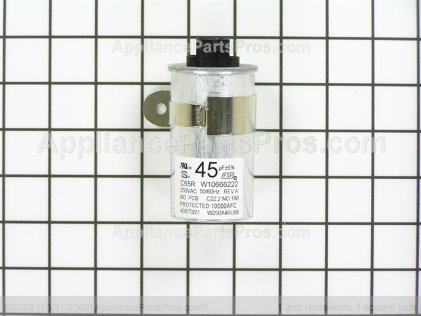

While I was down there, and having read some info on the capacitor and issues it can cause, I removed and tested it (my multimeter has a capacitor test function). It's supposed to be a 45uF capacitor but it only reads to 28uF. The cap is encased in a black plastic shell, so I can't tell if it's bulging, but there was some clear liquid clinging to it, which may be electrolyte or it could have been a very, very light oil. Dunno. But it was so clear, I'd guess electrolyte.
So in light of that, should I at least persue the what looks like a bad capacitor as a possible cause for this?
Please let me know, thanks.
106,343
Bingo! Yes, order the new capacitor.
Here's the capacitor for your model to order:
W10804665

When I received the new capacitor, I first tested it using my multimeter and it read the correct 45uF. I then reinstalled the splutch, the shifter, the new capacitor, the main pulley wheel, the belt and the belt cover. All went well. The first thing I did was run calibration mode, and that finished with no issues. I then started a regular wash cycle and that also worked with no issues. Dispersal mode and the normal wash mode ran issue free with the agitator once again correctly turning in both directions. No issues with drain or spin. The machine is as good as new again!
