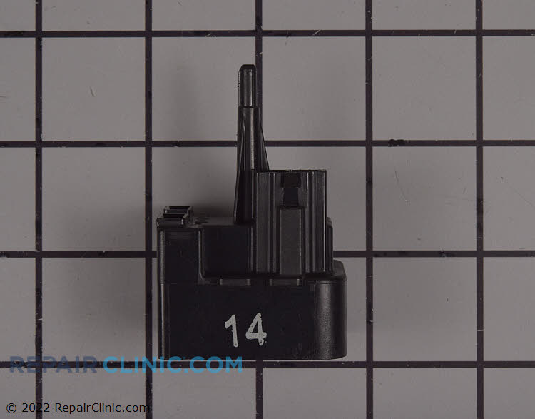

A thermal overload would prevent the compressor only from running.
Your compressors thermal overload is built together with the start relay.
LINK> Compressor start device
