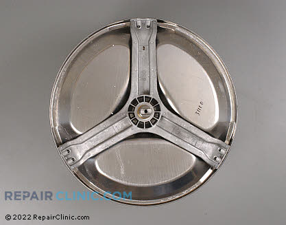

Our 5 1/2 yr old kenmore front load washer started make a loud noise this week...after reviewing some of the other post, I opened the front cover to find a broken shock.
I replaced both shocks today and still have the loud noisy during final spin cycle...as others have mentioned it is like an airplane taking off - very very load.
It appears that I'm in need of bearings or replacing the whole tub assembly...
Can anyone give me rough cost for these projects? Do you have a part # for the whole tub assembly?
I'm thinking of doing it myself or should I hire someone?
Help!
Here is the part number I came up with #131525500. This is a technical repair. On a scale of 1-10 with 1 being the easiest, I would rate this repair a 9.

The only front load washer you can replace just the bearings and seals is Maytag Neptunes, that I'm aware of anyways. It also requires the special tool kit. The bearing installer kit for that model was $425.00. Here is the one you need:
Drum Assembly 131618500
