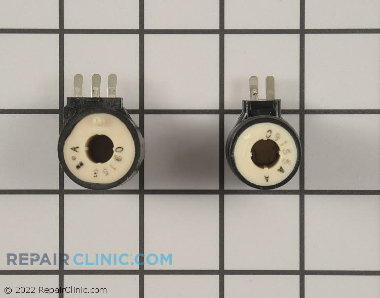

Some heat? When you first turn the dryer on do you hear the gas flame come on and stay on for a couple minutes, then the gas flame go off, then little to no heat for the rest of the cycle?
If that's the case, the problem is the gas coils have gone bad mechanically when that problem happens.
Here's the gas coil kit for your model:
Gas Valve Solenoid 279834

Looking through the hole on the front, the ignitor heats up, i hear a click. gas does not turn on and the ignitor goes out. So in fact the flame doesn't start for a minute at all.
Does that still sound like the solenoids?
Yes, or the whole gas valve but usually just the coils are failing. They're much cheaper!

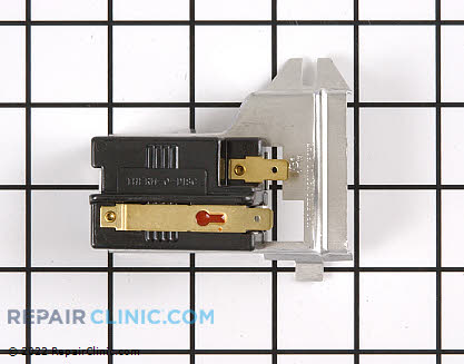

If you see no flame at all at first start up, I'd ohm test the flame sensor first just to make sure that's good.
Ohm test it with a multimeter. Unplug your dryer first before taking it apart and ohm testing it.
Here's the flame switch(sensor):
Flame Sensor WP338906
I replaced the solenoids and that did it! I figured I would do that before disassembling anything else. I didn't have a convenient access panel so i had to open up the whole thing but it still took only about 20 min. Thanks!
