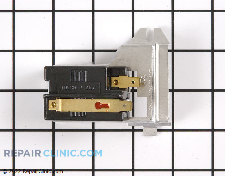

Hello again! I think I have tracked the issue down to the Radiant Sensor. I removed it from the combustion cove exterior to test for continuity. When testing against the connector tabs it showed no continuity. Touching the frame/bracket of the sensor did show continuity but the tabs did not. Did I find the issue? 🤞

Should I go ahead and replace igniter and coils too after the Radiant sensor while I have it all apart?

I'd try the sensor only.
If you are brave, I use to touch those 2 wires together from the sensor to see if the igniter would come on.....if you wait until the igniter to glow good and bright and then separate those 2 wires the flame should work.
LINK> Gas dryer sensor for igniter and flame

I replaced the sensor only and the igniter still won’t glow. I am going to replace the coils and igniter too, see if that helps.

By your picture, the flame sensor was definitely bad.
