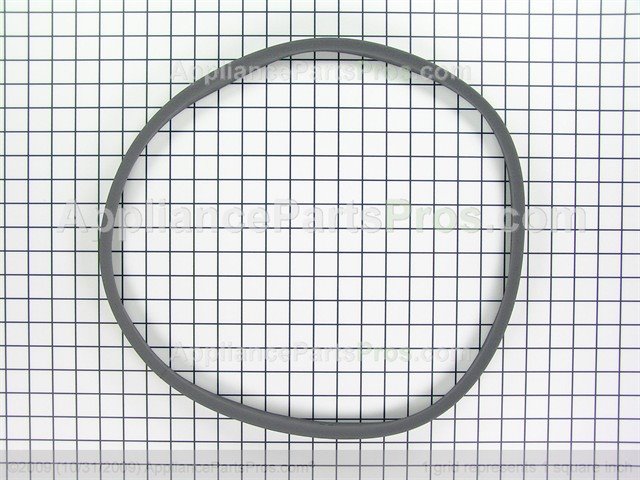

So when I was checking the drum temp if the temp probe moved near door it would drop temp quickly. I had installed a new door gasket about a month before we started having problems. When I looked at it, I put it in backwards so it was letting air in to mix with hot air. So basically I rebuilt the dryer to figure that out! I think my wife is going to take away my tool box! It does explain why everything kept testing ok like thermistor/ heating element etc. Anyway Jake your advice to check those two temp locations was really helpful. I had totally spaced on the door gasket install and never made the connection. Installed backwards it kinda closes ok but It is not obvious. Thanks again!
Glad to hear you found the problem.(y)
Here's the door gasket for your model, in case others need it too:
Door Seal MDS47263101
