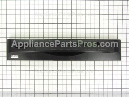

Yes, sounds like you control panel is now bad, don't know if the new control board took it out or not, it was likely the old control that took it out since it was burnt.
Here's the ones I found for your model, just choose your color:
Black:
Whirlpool WP8269826 Control Panel - AppliancePartsPros.com
White: No Longer Available

Is there a way of testing the control panel? Since it is a rather expensive part, it would be a bit more comforting to know for sure before buying another.
As I said before - the control panel did work for all features prior to the control board replacement - it's just that the heater wasn't working.

I'm going to throw what is likely good advice to the wind - the Mrs. would rather I try to fix this thing so I've ordered a new control panel. (She's not interested in paying the price for a new machine that has the features of this old one.) For this go-round, my safest answer is "Yes dear!". Will let you know if the new control panel does the trick.

I'd like to report that I installed the new control panel and the dishwasher now works again.
Thanks for the help! You've saved me the pain of going out and buying a new unit.
