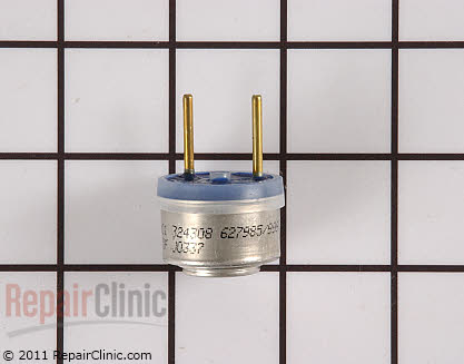

A normal ice maker cycle is about 90 minutes, if not then its possibly your ice maker thermostat that's bad.
If you want to test that thermostat, you will need to read the temperature that's labeled on the thermostat to see what the closed temp. is. Then you'll need to get the thermostat cold enough to reach that temperature and ohm it to see if the contacts inside are closed, which would be continuity and meter should read 0 ohms.
Here's the ice maker thermostat(you have to order the thermal mastic(Alumilastic) as well if you replace the thermostat):
Icemaker Mold Thermostat 627985
There is a video in the ice maker thermostat part link to show you how to access/replace it.
The Alumilastic Cement for the thermostat goes where it mounts to the mold and heater assembly.
Here it is in-stock.:
Or you can get the entire ice maker assembly:
4317943 Whirlpool Icemaker Kit

Yes, the mold heater should come on, you should feel heat underneath the ice tray mold.
The heater should have a resistance reading approximately 72 ohms.
It works like this; When the thermostat reaches a set temperature it closes and completes the circuit to the motor and the ice maker starts a harvest cycle. Shorting holes"T" and "H" bypasses the thermostat and starts a harvest cycle. When the ejector reaches the 2 o'clock position a switch is closed and power is diverted from the motor to the heater. When the heater turns on it begins to loosen the ice cubes in the mold and the thermostat opens. When the thermostat opens power is switched back to the motor and continues through the harvest cycle. At the end of the harvest cycle the ice maker supplies 120 VAC to the water valve for about 7 seconds. After the fill cycle the ejector reaches the park position and opens the circuit for the motor. The circuit will be complete when the thermostat reaches it's set temperature and closes again.
Here's the mold heater assembly for your model: https://www.repairclinic.com/PartDetail/Ice-Maker-Mold-And-Heater/WPW10190929/1471721
But that part costs more than the complete ice maker itself, so it would make more sense just to get the entire ice maker assembly.
