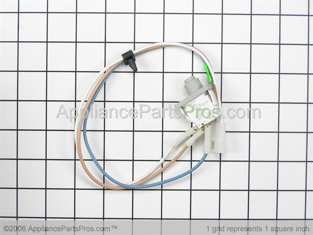

My dryer did the same thing. Turned out to be the DOOR SWITCH. The switch has two contacts in it like "points" in old cars. If you open the door to stop the dryer instead using the buttons to shut down, all of the voltage "arcs on those points" and stops the "continuity" and the dryer doesn't get the signal that the door is closed. It won't start! Look at the schematic and you'll see the switch in the upper right hand corner. The blue wire needs to make contact with the white wire. BTW, the switch is almost impossible to clean and reassemble....

He said he already checked the DOOR SWITCH.:)
Steps taken:
--->Ran Diagnostic Mode: all tests passed, including opening and closing the door.
But, thanks for letting us know it was the DOOR SWITCH on yours that was the problem.:)
This is how to test it below:
You will need a multimeter to ohm test the door switch.
Here's that door switch for this model:
Door Switch WP8283288
There is a video in the door switch part link to show you how to access it to check/change it. Make sure your dryer is unplugged first before accessing it and ohm testing it!
Push the button in on the door switch with one meter probe on COM and the other meter probe on NO and see if it reads.
