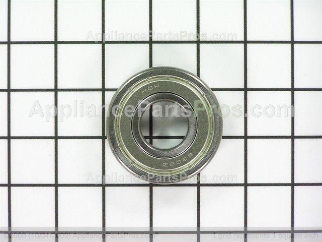

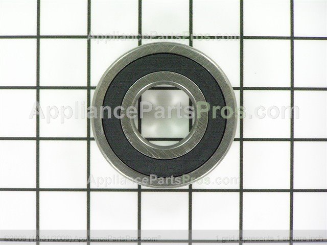

Yes, you would need 2 new bearings and the bearing seal. Its a big job to do, so allow yourself plenty of time to do it.
Here's the bearings and seal for your model below.
MAP61913707 Tub Bearing
MAP61913708 Tub Bearing
4036ER2004A Seal
There is a video when you click the tub bearing seal, it will show you how to replace both bearings and the tub bearing seal.
