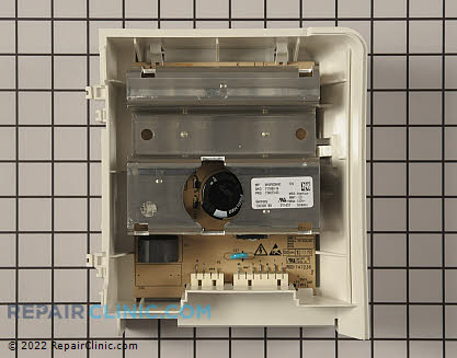

Ok Next lets check your MCU and Motor itself. Make sure your washer is unplugged first!
TO CHECK: Visually inspect the MCU for burned spots on it first. The MCU is located on the left side once you have the lower access panel removed.
Now if you find burnt spots on your MCU, then that's the problem, just order a new MCU from the link below.
Now if you DON'T find burnt spots on it, it can still be bad, but we would need to ohm test the motor itself first to see if your motor is good. You will need a multimeter to ohm the motor pins.
Remove the electrical connector from your motor then on your motor connector pins itself - Test pins 1-2-3. 1-2 then 1-3 then 2-3 should measure 6 omhs. If you get 6 ohms on those pins each, then your motor is fine, so you would just need to just order a new MCU from the link below.
Here's the motor control unit(MCU) for your model:
Motor Control Board 8183196 Order now for same day shipping. 365 day return policy. RepairClinic.com
