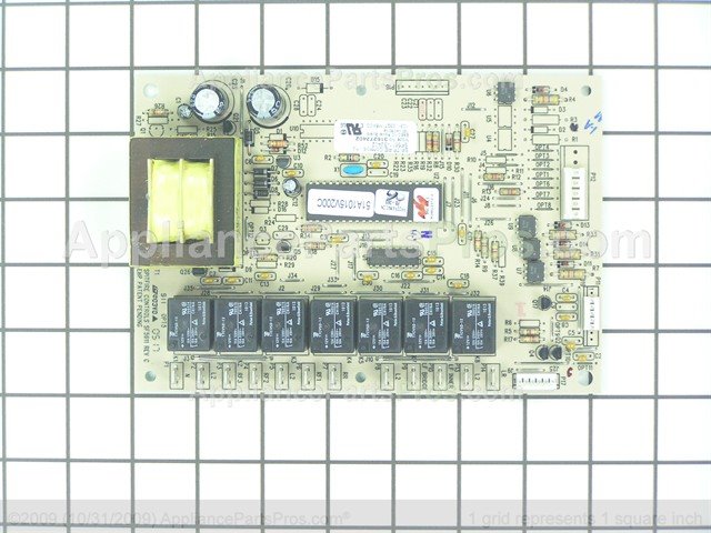

Unfortunately, the oven relay board is No Longer Available:
Board 316272402

Ok, dug a little more into it. maybe you can help with some advice, direction, and knowledge!
There are two main boards. One down low left on the back and one right behind the clock. (pics below)
bottom left one
top behind clock one
If you look here, at the top center one, there is a resistor/diode that looks like it might be burnt/expanded. The doohicky to the right has some dark areas too.
I tracked the wires to the heating element to this board (the top center one) and wiring is complete (unknown if its correct resistance, but its not open)
I was able to get a used lower left board off ebay thats supposed to be good for $40 shipped. So that will be a test, but could the issues im having be explained by the top board having issues? Im finding those out there online but in the 140$ range (pun intended). More than I am ready to toss down at a blind guess.
Yes, I see that, good find!
Yes.
Here's the clock/oven control board for your model:
Oven Control Board 316418750
Here's a test you can do if you want to confirm that--->Set your meter to measure Volts AC and measure between "L1" and" L2 IN". If your meter indicates 240 Volts AC the clock/oven control board needs to be replaced.
Becareful if you do this test, do touch anything else when working with LIVE VOLTAGE, and unplug the RANGE after your done.

Ok, few updated tests. Again THANK YOU SO MUCH FOR ANSWERING ALL MY QUESTIONS!!!:):):):):)
I purchased the 40 used bottom board. It came in today. No change in symptoms. But it does work just like the one that was in it.
I checked to confirm 240 power at the range side connections, check
Poles on the top board that I tested.
Listing on them is left to right
L2 IN
L2 OUT
Conv (no wire)
Bake
Broil
L1
L2 out to L1 with oven off 110
L2 out to L2 in with oven off 110
L2 out to L2 in with oven on 240
L1 to L2in indicated nothing. Even with oven on or off
Im not sure if I understood your instructions as you said if it reads 240 then it needs replacing? I was expecting the opposite!
I was unable to get any reading from the tabs that go to the oven element.
But was hearing it click when it was turned on or off.
So thats where I am! If there is another check oven on or off just give me the direction. I feel like its probably time to just replace the top clock board assembly.
